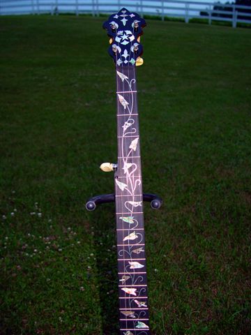

Here's an 1890's Acme Banjo,(made by S.S. Stewart), which needed a slight over haul. It was missing over half of the inlays and had numerous sections of fretboard missing.

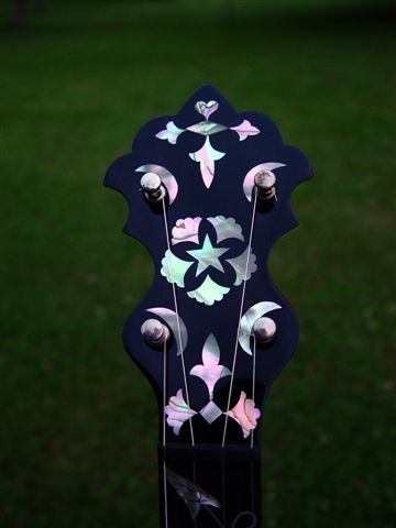

We decided to replace the fretboard, all the inlay, and re-finish/ repair the headstock.

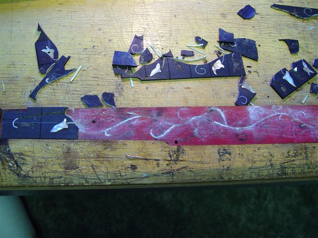

Here's the fretboard removal!
They had cut every inlay slot completely through the board. (Where was dremel company )

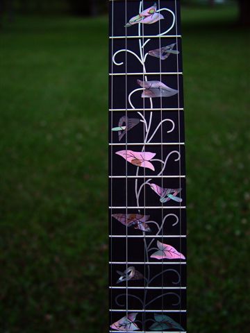

The completed restoration.
Pale red ab and pewter for the vine.

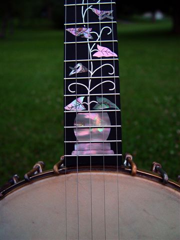

this last image includes the only inlays salvageable- The "flower pot" at the bottom. most of the inlays were only about .008, probably due to the fretboard being sanded down during it's lifetime.
I took plenty of photos and measurements prior to beginning the job to keep everything as close as possible to the original,(including the flower pot slightly off center!)
It was truly interesting to uncover the techniques that were used to cut and inlay back then, without any type of router.
Thanks for looking...........

Ron, I never had a fretboard come off in pieces before;
Now that I think about it, it was enjoyable!!!!
The headplate inlays were actually cut to fit the existing recesses, which had lost most of the shell.
